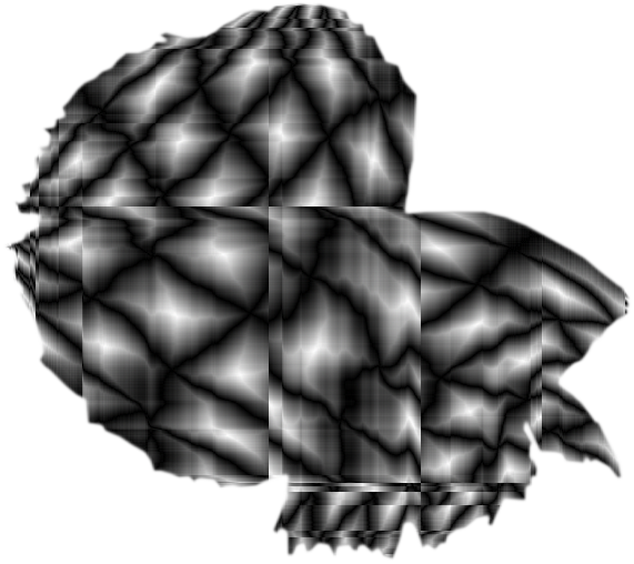

 Post subject: Re: Looking for a "Blending" - Script-fu or plug in
PostPosted: Mon Mar 12, 2012 1:25 pm  (#35)
Posts: 12775
I missed this thread since I crashed for more then a few days after a long contract job at that time. Fastastic stuff RobA and Saul. Only played a little with it a few minuts ago. Took one Silvertayl's Siamese Fighting Fish Brushes as hard selection and ran RobA's Script-fu in the Horizontal and Vertical (vertical much slower then horizontal) and set the top layer to difference. The block areas are weird though and am not sure what causes this effect (see something similar with Saul's Script-fu after I drank a 16oz diet-coke (slow but worth the wait)) so I guess the selections need to be a smooth curve or else. I see fantastic potential for both so happy I am and thanks again to both of you gurus. :)
