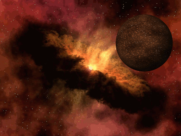

 Post subject: Re: Spinning World Tutorial
PostPosted: Sun Jul 17, 2011 5:28 pm  (#11)
Whoa nixnine! That is mysterious, spooky and downright awesome. Very nice job!
