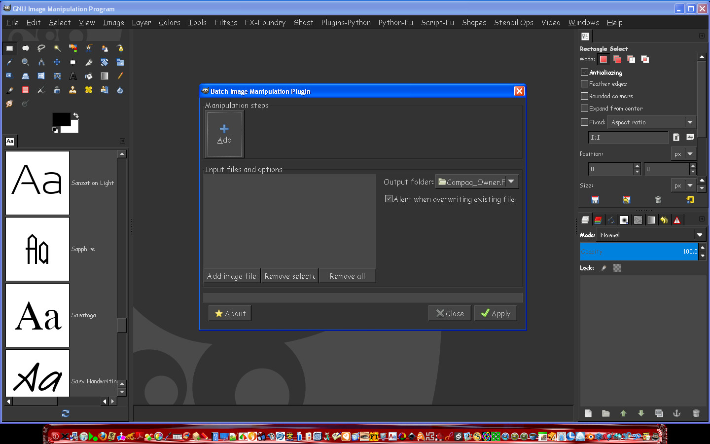

Just got round to compiling this for linux & Gimp 2.8 RC1, seems to work ok.
Tried it on several images with the presets, that worked. The watermark function could well be useful.
Just a test on a single image and "Other Gimp Procedure" not 100% but more likely something I was doing wrong.
Screenshots, bit large so I won't post in-line http://i.imgur.com/hHDvV.jpg
