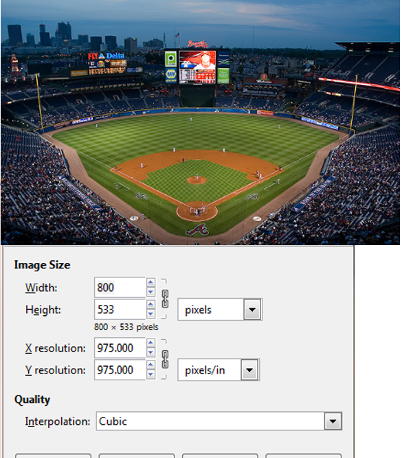

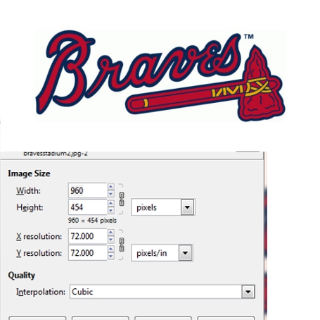

Below are the two pictures i plan on using to make my picture. Below each picture are the original image sizes for each picture. So let's say i make a picture to be printed with these two images, and the size i want that picture to be is 8x10. Am i gonna run into any problems with this if i make no changes to these two images?.
I changed the size of the picture i wanted to make because i wanted to make a poster. but i changed the type of picture i wanted to make. Later on i do plan on making a poster. My guess is that the second image resolution must be increased to above 300. Is there anything else i need to be worried about. I know someone said that the color's come out darker in print than on your screen, so should i lighten the picture up in gimp before saving the picture? Thanks. I really want to make this picture and try and have it printed on Monday so any help you give will be appreciated.
Picture 1)
Picture 2)
 Post subject: Re: I Need Help..
PostPosted: Sun Mar 03, 2013 4:57 pm  (#10)
Joined: Nov 09, 2012
Posts: 65
Location: Bedfordshire, England
The "Braves" image is low on detail and it may actually be possible to increase the size quite effectively as the extra pixels to be added will be the same as the ones they will be going between.
The stadium image is a different matter - printing an 800 pixel image at 10" is only 80 pixels per inch. If we look at the vertical size (assuming you crop the sides to fit into the right shape) a 533 pixel image printed at 8" is only 66 ppi.
As I said above, I think 150 is the minimum for a quality print - although Ofnuts' figures suggest going down to 112 may be okay. Either way, 80/66 will probably not look that great.
