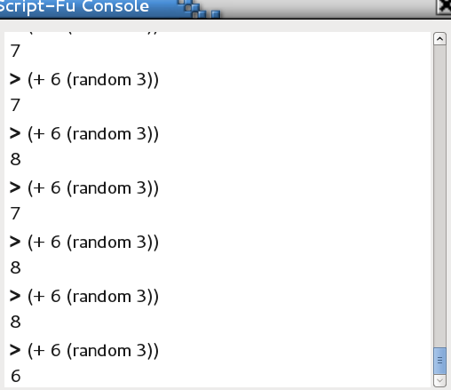

Your example is: (+ 6 (random 2))
Should be (+ 6 (random 3)) ... works for me..
 Post subject: Re: Random numbers PAIN
PostPosted: Sun Sep 02, 2012 9:22 pm  (#4)
Thank you Tux I did not know you could use the console to test equations,that is great :hi5

(random 3) returns 0,1 or 2 but never 3
