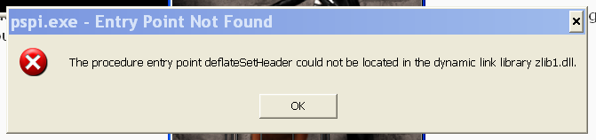

Well actually i have this error now with the windows 32 version -
It will fire and run but it dioesn't recognize any images except its own format xcf.
ie ... i can not open anything other than xcf files -
Also none of the installed plug-ins show ... Filters menu only shows filters i add
and they won't run because they are python files - python console shows but python doesnt work :lol
So in short until i can figure out the above error - i have no installed plug-ins other than color filters
and GEGL operations do work also.
No scripts work at all.
Any idea what that error means PC?
By the way here is a screen shot

I' am installing now i didn't try yet
You may try to open preferences/folder/plugin and check if both path are correct (the important is that for ...Program Files/gimp/ lib/....plugins.
If was there the problem correct the path will fix also script fu (that depend from a plugin, script-fu exe or a similar name)

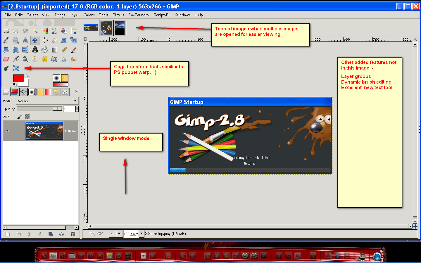

Willy wrote:
is that what 2.7.2 looks like mate? Too me it really doesn't look that much different, is it that much different that it is worth all of that work? Screenshots pleases?
Well, it was worth it for me. :)
Anyway, one major (to some) selling point is the single window interface. Also, for me the text tool was broken in 2.7.1 which is fixed in 2.7.2. You should check out the cage tool and let us know if you think it is worth it. :)
Partha

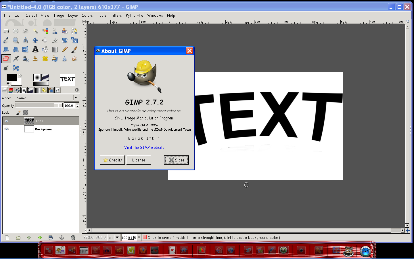

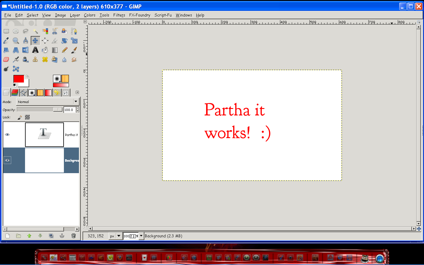

Sorry i took so long to answer Partha - machine was running real sloooow other downloads for guitar stuff :lol
The file is okay - i downloaded windows 32 which is what i needed -
I just needed to place the entire gimp-2.7.2 folder in program files directory and it runs fine now. :)
So place all the dll files in windows system folder and the gimp-2.7.2 folder in program files directory.
It should run fine now with Python i think.Yup it does :)
The only error i get now - pretty sure i can fix this though
Snapshots for willy
What it looks like now with Python added
I have not ran a test to see if 2.6.11 still runs okay ill do that next - not too concerned about it now though.
