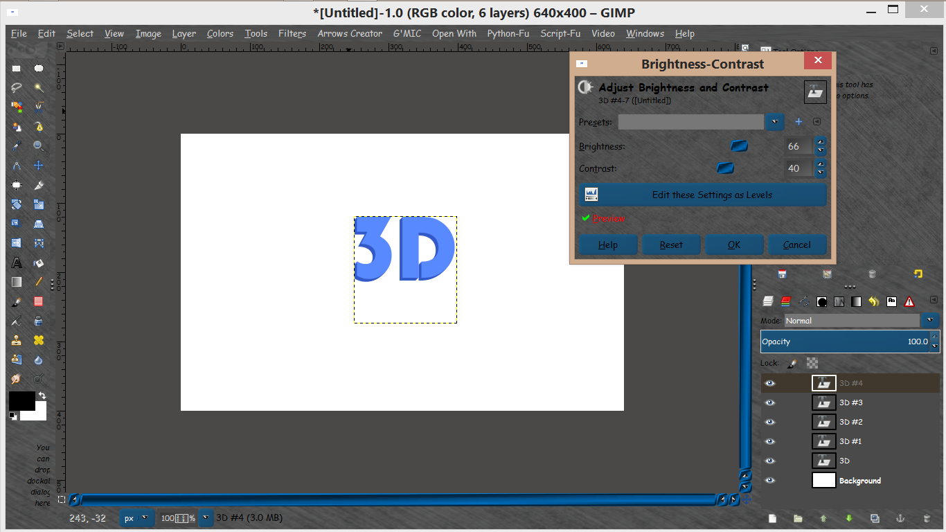

sallyanne wrote:
I still cant do 3D letters without a script :oops:
Very simple tutorial for you. :)
Create your text.
Duplicate the text and move it 1 pixel whichever way you want it to 3D from. For instance 1 pixel up and 1 pixel right would make the 3D from the bottom left. :bigthup
Lastly on the top text layer just go to Colors> brightness and contrast. Play with the settings.
You could also stroke the top text layer and fade the opacity a bit.
Results after 5 layers -

Posts: 8511
Thanks Rod. I only tried with one extra layer. Didn't realize it had to be done a few times. Will try again soon.

Have followed your tut now Rod and I think I got it. Have to do it better though yet.
