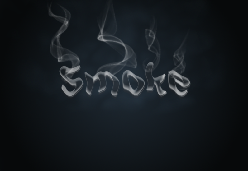

PostPosted: Tue Feb 12, 2013 5:24 pm  (#1)
i think i got tricked by K1te again :mrgreen:
he casually dropped a tutorial, making me believe it means nothing at all, while complimenting me on my tutorial
of course i took the bait - the innocent non-smoker i am :?
that wasnt easy to replicate - and i still dont know how they get the blue glowing light effect with dodge, so my smoke is greyish-white
PS tutorial here:
http://abduzeedo.com/smoke-type-photoshop-10-steps

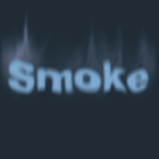

That is a conspiracy theory in the making!
The same here - I could not replicate it in PS6, I made an attempt in GIMP about 2-3 weeks ago and ended up with this
I think there is a step or two missing in that tutorial.

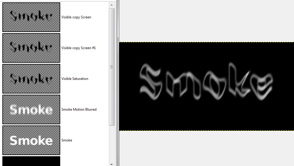

heres how i made the smokey text:
01. make weird text as in this tutorial
viewtopic.php?f=23&t=6406
in this case it can be a bit blurry - we want that
02. duplicate text layer and apply Motion Blur on duplicate
align MotionBlurred layer a bit
03. set MotionBlurred text to 'Difference' and without the BG, use 'New from Visible'
04. apply 'Filters -> Distorts -> 'Ripples'
once vertical and once horizontal
05. duplicate twice, set upper two layers on 'Screen' and the first Smoke-layer to 'Saturation' 30%
offset 'Screen' layers a bit

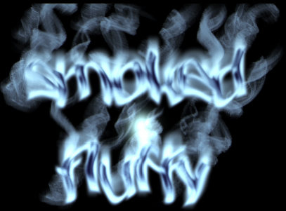

My Poor effort below↓ a great tutorial Esper and i think you've been had by K1te again :hehe :rofl

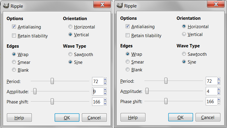

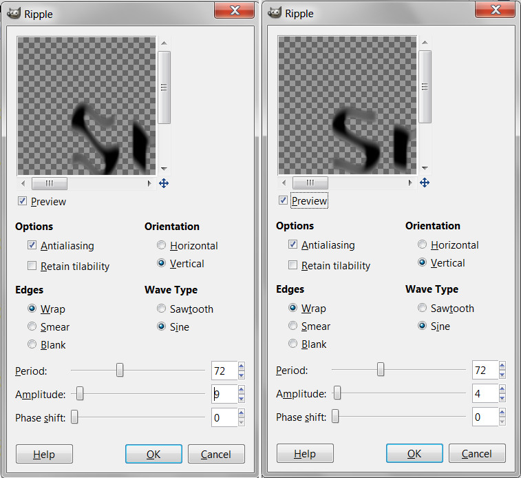

http://www.gimpchat.com/viewtopic.php?f=23&t=6406
It shows in your screen shots that you did them both vertical. Is that just the wrong scr shot?
 Post subject: Re: Smokescreen
PostPosted: Wed Feb 13, 2013 7:05 am  (#18)
thats a mistake, the one with Amplitude 9 is the vertical and the other one is horizontal
but its not really a tutorial, just a quickinfo for the basic steps how i made it, you have to make it your own
maybe the waved text could be improved, but Ripple was the best filter i could find for the job
EDIT: i updated the screenshot
